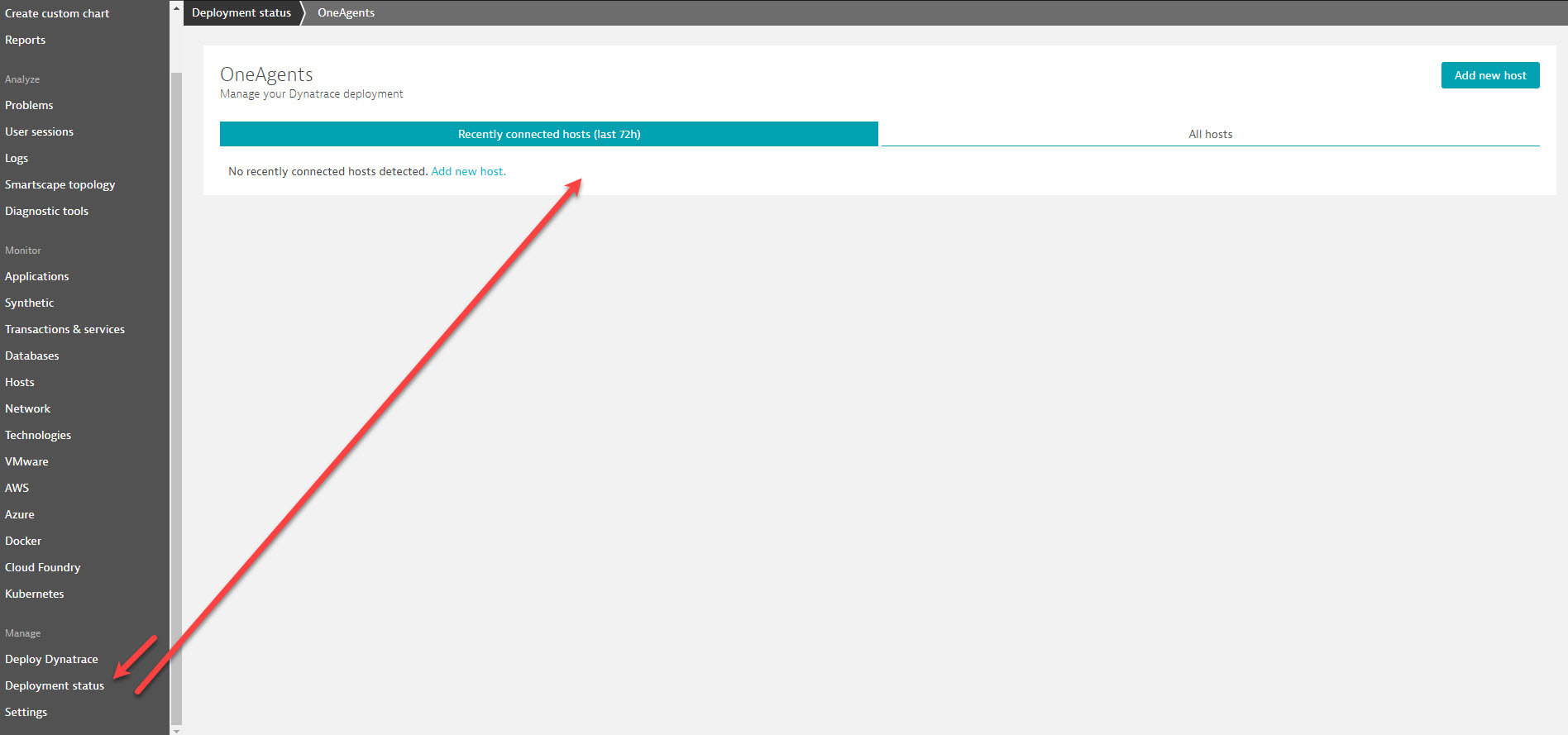

Hey @Shashank A. Depending on the environment you were in when you downloaded/copied the install script for the oneagent, Will determine what Environment that host will show up in. You can check that several ways. Go into each environment and click on the hosts and look for the one you just added.
Or you can scroll down on the left hand side to the "Deployment Status" click it and select "OneAgent" and it will show you hosts that have connected to that environment in the last 72 hours.

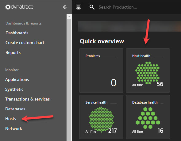

Hi Shashank,
If you have followed dynatrace one agent deployment wizard (deploy Dynatrace) from the dynatrace console then the instruction already included tenant ID(environment) in the installation step.
if you are not sure about the installation steps then lengthy and painful process is to go into each tenant(environment) from the console and press "Host", which will show you all connected servers.
Please see attached screenshot for reference.
Please let me know if you have any question or concern.
