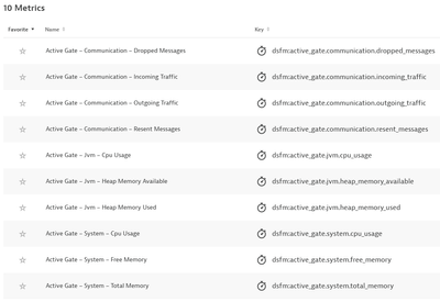

AntonioSousa
Yes, having this information, especially over time, might be interesting.
You're probably concerned about traffic management, so you might use the new dsfm: metrics, that you can even put in a nice Dashboard:
