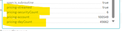

I was kicking the tires on using OneAgent SDK in a Java (Jersey/Tomcat) application to enrich existing service request traces with additional computed attributes - for example a boolean indicating whether the service chose to stream a response or not. Using code quite like the SDK's example on a Path-annotated method on a Resource class that corresponds to a Dynatrace-monitored service:
oneAgentSdk.addCustomRequestAttribute("pricing-streamed", Boolean.toString(isStreamed));
I'm now seeing this "pricing-streamed" value (and a couple others I also added in code this way) showing up in traces at code-level under a category "Metadata" on the Jersey AbstractJavaResourceMethodDispatcher dispatch call:

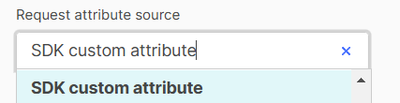

Hello! Everything is done correctly, except that on the Dynatrace side, this attribute needs to be added and the type SDK custom attrubute should be specified
More screenshots in blog.
Hope it helps.
