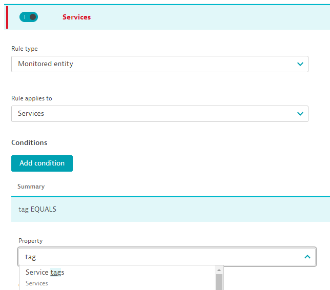

the Entity selector will only allow you to select one type of entity at a time, so you can create a set of rules for each, Host, Services, Process Groups, Process Instances.
You can also use the monitored entity section and add in the rules for tags on each entity type:

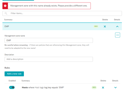

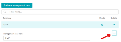

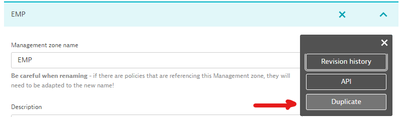

The API can be a bit of a burden for a one off job (perfect, and recommended either via scripting or monaco for automation use cases).
The UI designers have recently added in the ability to duplicate an existing config from within the UI, duplicate it, make the required updates and you can save the time writing a bunch of API calls for a new app.
e.g.
the click Duplicate, and you'll have that MZ definition copied as new items, with all the rules, ready for editing.
So if you already have a MZ built the way you want, and just want to re-use it for a new use case, just Duplicate it.
You can do this in other areas of Settings as well (anything supported by Settings 2.0 should work).
