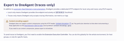

Are you ingesting the traces through the API? In this case, since you already have the agent, you might want to try and send those trace through the OneAgent.
OpenTelemetry traces with OneAgent - Dynatrace Docs
This should merge any span you created into a single trace:

I tried to follow the steps as mentioned in this page https://docs.dynatrace.com/docs/shortlink/otel-getstarted-otlpexport#export-to-oneagent-traces-only. But it did not work on the K8S port.

It looks like the default 14499 port for one agent to capture trace logs from OPTL is not listened on the localhost.  Any idea about this part? Is that anything I need to do to enable it on the k8s pod?

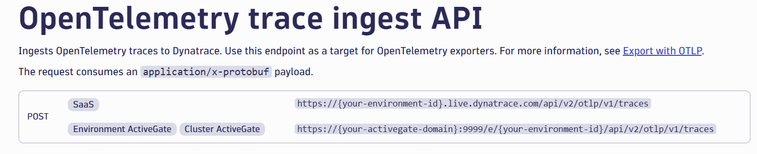

@xuzhao2024 in Kubernetes, the EEC controller runs on the K8s node, but it's not accessible from pods. You need to send OTLP data to ActiveGate or Cluster. See https://docs.dynatrace.com/docs/shortlink/api-otlp-traces
Depending on your DynaKube configuration in your k8s cluster, you might be able to send it through the ActiveGate running in kubernes - if it's deployed in your setup, and you have dataingest enabled. By default the embedded activegate in k8s is reachable under https://<dynakubename>.dynatrace:443 , but by default it has the self-signed certificate, so you have to configure it properly either on the ActiveGate (in DynaKube, see this and this) or on the exporter.

  • Depending on the actual deployment of K8s, you should send the Opentelemetry data to the same end point where pods and AG are connected.
  • You can apply a simple change in the Opentelemetry configuration, make sure it's sending the data to either cluster or ActiveGates.
