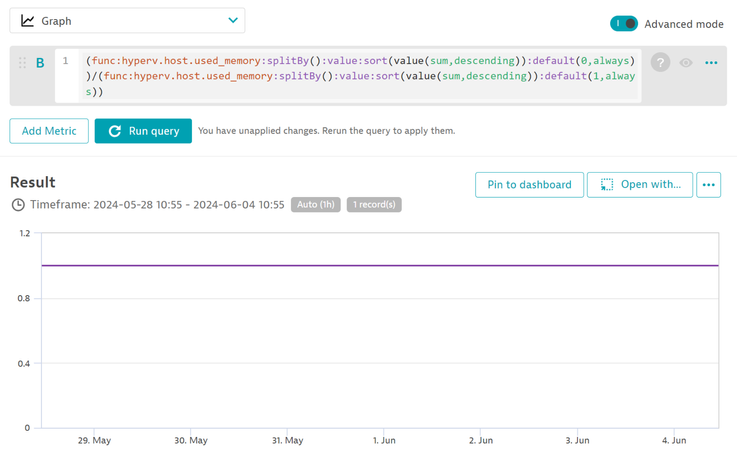

Hi henk_stobbe,
To avoid the 0/0 error you mentioned, you can use the default(1) option in the denominator instead of default(0). This way, if there is no measurement, the denominator will be 1, and any number divided by 1 will be that same number, while 0 divided by 1 will be 0 and will not cause an error.
Here is how you can adjust your metric:
var_total:default(0)/var_part:default(1)
