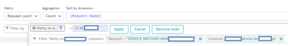

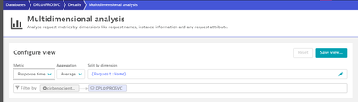

we've one service running in 6 process instances. This service calls to the DataBase. We are interested in view the response time for those database calls.
I know we can do this by setting in the multidimensional view setting the Called by filter:
but how can I restrict this with only the statements called by one of the six service service instances?

I am not sure whether I understood the requirement properly. What can we do to filter out the service instance level in service flow and then, select the statements icon of the database that will take us to the multidimensional analysis with the filtered database statements only for that specific service instance.
