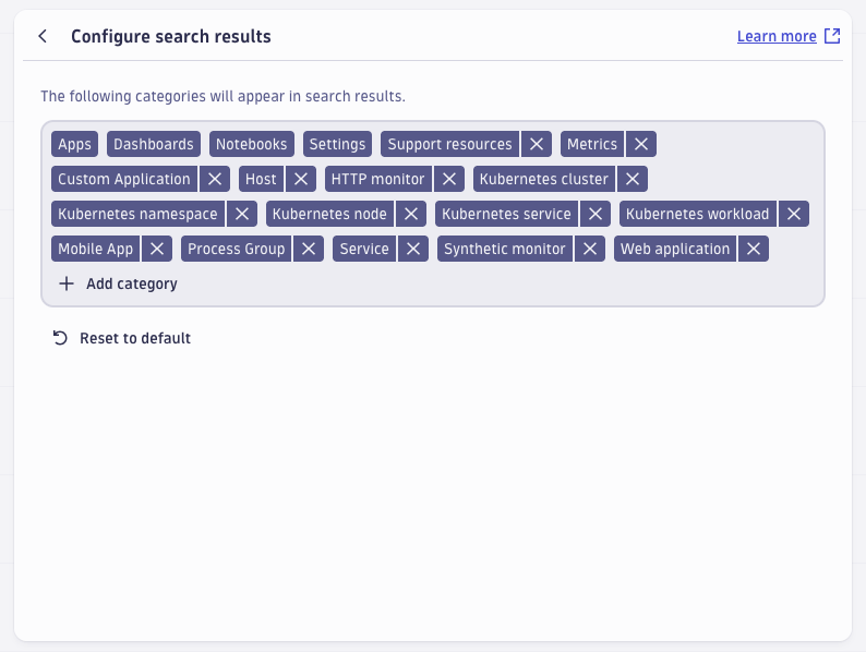

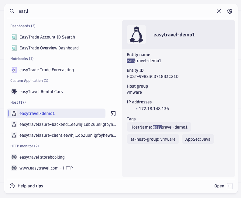

Hi again @mario_rwwa and @uhh I have some good news to share: with release 296 we now support searching for a subset of entities in the default search results. You can also configure your default search categories. In the next months, we'll release an additional update that will make it much easier to select specific categories. Docs update coming soon to reflect this!
And please let us know if you have any feedback!

Spectacular! I searched using one keyword and was returned dashboards, notebooks, workflows, hosts, process groups, and services that all contain the keyword! Huge improvement, great job @GabrieleHB & team!
