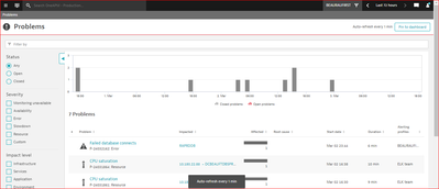

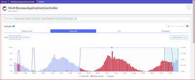

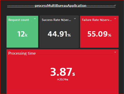

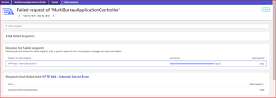

We have observed a 100% failure with http 500 internal server error in a specific service but no problem was raised during the timeframe the baseline is also set at auto-adaptive and during the 7-day timeframe no anomaly was observed. can anyone please guide me on how to approach this issue and help me to resolve it. PFB Snapshots.

AntonioSousa
@Vikas_g199,
It seems this is due to not having at least 10 requests per minute. You are looking at 72 hours, so it is aggregated, but I would say it doesn't pass the requirement needed for Davis to raise the problem automatically.
Given it's at the service level, you can adjust sensitivity of anomaly detection by following the configuration hints suggested in:
https://docs.dynatrace.com/docs/platform/davis-ai/anomaly-detection/adjust-sensitivity-anomaly-detec...

@Vikas_g199,
Looking closely at the graph, you can see that a problem was generated yesterday by 3 PM, in a period where the 10 requests/min was probably surpassed.
