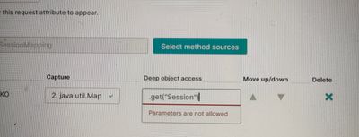

I want to retrieve the key values ​​via request attributes for the java.util.map method
I try via get("key") but dynatrace writes an error
how can I get the value of the keys?

here is the usual code in java and from it I need to extract the key value
The screenshot shows that dynatrace does not allow this to be done as can be done in java code

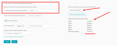

Maybe you can capture the result of your method ( Change the option Capture) , because it will be a string like " SessionId,47488338 ", and then you can use the "Restrict or further process the captured parameters" option.
I hope it's helpful  💪

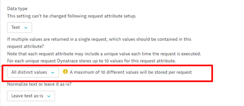

and there can be up to 50 such values. Can dynatrace see them all?
Try this

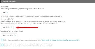

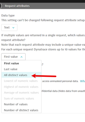

Hi @Hector1
If your method is going to be executed multiple times in the call (and at those times different data will be sent and those different values must be captured).
NOTE: It is important that you know that with this configuration only 10 different values are captured.
In that case, what PacoPorro recommends is a good alternative 💪.
