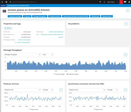

On the Dynatrace demo instance we can also find ActiveMQ Artemis detected as separate Technology and distinguished from ActiveMQ

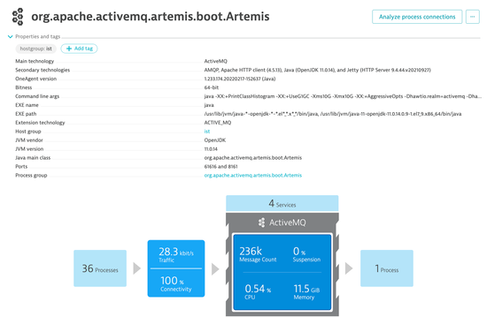

In my tenant however ActiveMQ Artemis is detected as "normal" ActiveMQ and no metrics are collected unless I use a custom JMX Plugin:

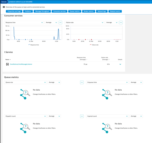

On the Queues screen then there is a ActiveMQ queue (which in reality is a ActiveMQ Artemis Queue) which shows no queue metrics, but reminds me to activate the ActiveMQ JMX plugin (which is enabled but doesn't provide any data since it is ActiveMQ Artemis)
