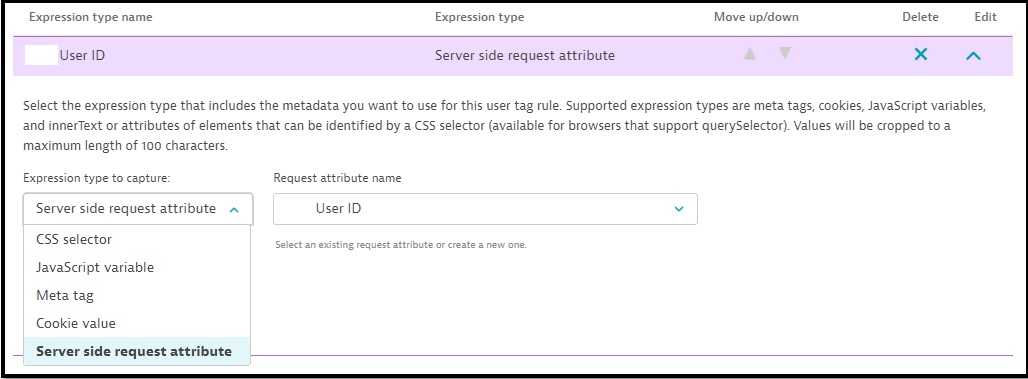

Please check if you have correctly mentioned where the attribute is stored, and steps are correctly configured.
Also, please share screenshot of the configuration for review.

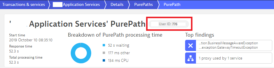

Hello @Akshay M.
The configuration is done correctly and I can see the Users ID in the request attribute on the server-side.

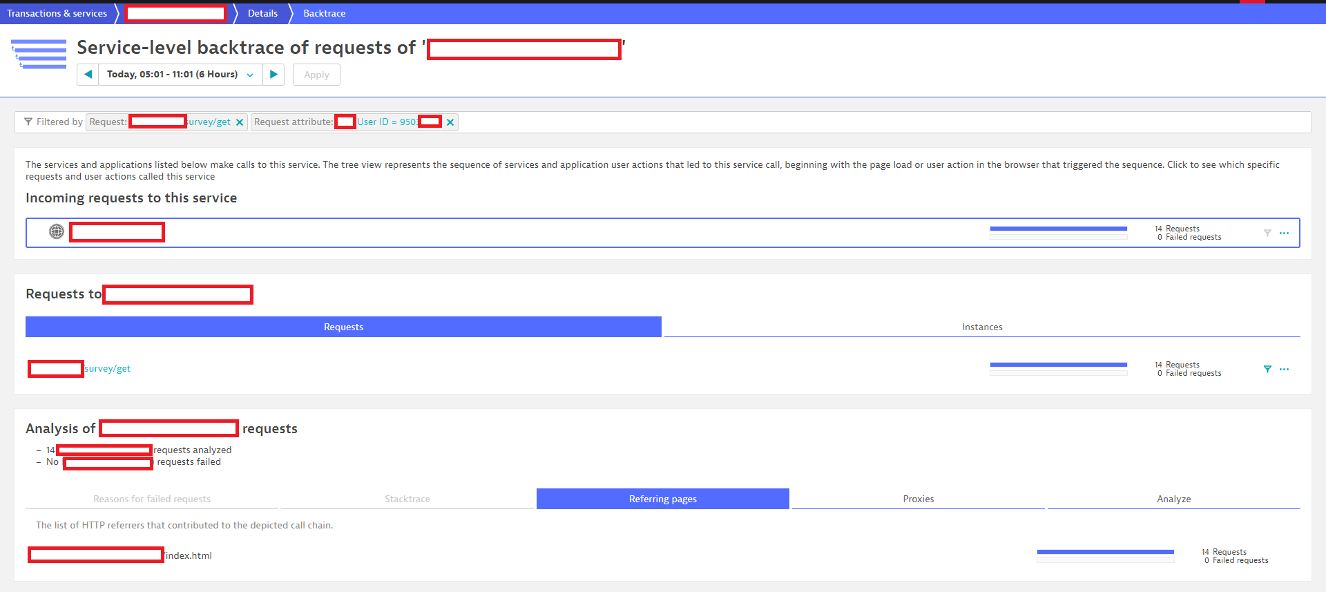

On these PurePaths which have the User ID, can you do a backtrace all the way to the RUM Application?
Hello @Radu S.
Yes, tagged actions are reaching to the RUM application.
I can see the following information:
Regards,
Babar
Radu
Dynatrace Champion
Dynatrace Champion
Hi Babar,
That does not seem to go to a RUM-enabled application. Your backtrace has only one node (the service which you started the backtrace). Hence why you're seeing "Requests to ..." but not "Requests from ...". Also, the last node of the backtrace (which needs to be a RUM-enabled application) needs to show User Actions.
Only User Actions are mapped to a User Session. So the problem is that the PurePaths where you are collecting User ID are not actually directly associated with any User Action of a RUM-enabled application and so it's impossible for us to use that attribute to tag sessions.

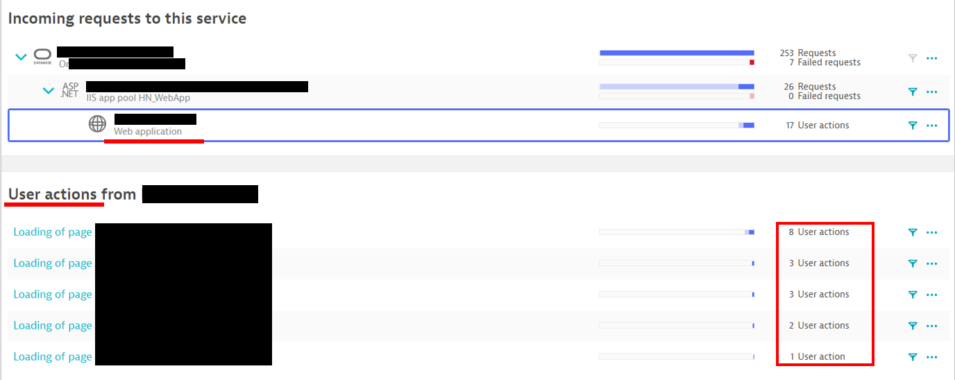

Babar, do you see this request attribute when you drill down to pure path from user action?
Sebastian
Regards, Sebastian
Hello @sebastian k.
After reviewing the below screenshot, please correct me if I misunderstood your question.
Regards,
Babar
