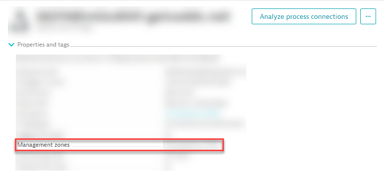

If that metric has a entity page, then in the properties you should see the associated MZs.
