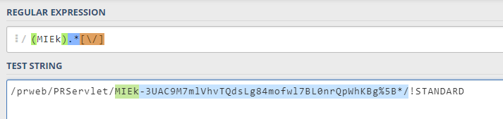

My customer wants me to try and cleanup the requests in Dynatrace for a number of the services in their monitored applications.
I tried to test the URL Cleanup rule for one of the requests, but the results were not what I expected.
The example that I was testing on, was for a number of requests in a service that are formatted similar to the below example.
Example Request:
/prweb/PRServlet/MIEk-3UAC9M7mlVhvTQdsLg84mofwl7BL0nrQpWhKBg%5B*/!STANDARD
The goal from my customer, is to remove/mask the string of characters that start with MIEk and end right before the "/"
Example Request (Part that should be masked in bold)
They would like to see these kinds of requests cleaned up so that they look like the example below.
Desired Output Example:
/prweb/PRServlet/*/!STANDARD
I attempted to perform this by adding a cleanup rule, however when I checked the requests, they all were being renamed with just a /
Results:
Does anyone know what I did wrong with my rule, and how I can properly implement this?
Thanks,
Adam Sjoerdsma
david_n
Inactive
Hello Adam,
Try this regex: (MIEk).*[\/]
Then you can replace it with: \*\/
Note: there is a backslash in front of the * but it is not showing up in the replacement regex.
Let me know if that works
Thanks,
David Nicholls
Thanks David! This helped me better understand how the regex needed to be applied.
