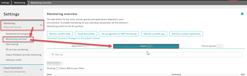

So you have a fixed limit for HUs but you don't have a process in which the onboardings are approved per the HUs available? What is the typical process for your onboardings?
You do have the ability to see it from the settings page as well:
But I feel that your onboarding process might need gate keepers to ensure that licensing quotas aren't hit and your Critical Entities are still being monitored.
