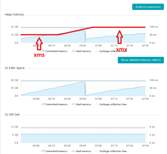

I think the committied memory = xmx (and xms). In my enviroments at different clinets xms = xmx, but if it would be different I would see similar to the red line below.
You can check the process java start parameters at the command line args line (process properities and tags).

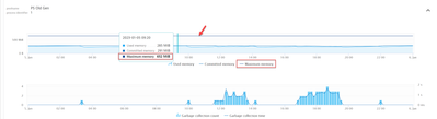

Thanks @Mizső ...this really helped. One more query please. I also see third legend "maximum memory" in my graphs (both for young and old Gen). What does that signify? I searched a lot, but could not get an answer for it. Please help. I have marked it in the below screenshot:

So the max in your example is the xmx in the jvm detailed features.
On the process base page max is not presented only the commited and used...
But commited can be very close to max.
