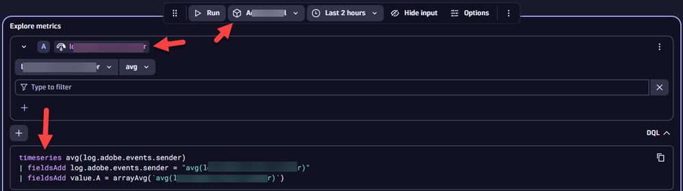

Hey @henk_stobbe ! I'm assuming you have already built the metric extraction. When you created that, it should have asked you to name it. You should be able to find that named metric in your data explorer. If you can see it in the Data Explorer, then you should be able to create the Davis Anomaly Detector for the alert overall.
In order to get this metric associated with a management zone, or the new segments, you will need to add it in using Dimensions with the Management Zones:
Hope this helps!

I see, you are looking to link the entity in the Problem Card? Try to build your DAD with DQL where it enriches the data to outline the source etc.
