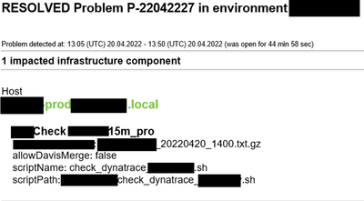

Recently I have found myself with the need to implement events from some custom bash scripts and send the events into dynatrace. I am sending an error event type right now in order to open a problem on the host on which the script is running on, but when I receive the email all of the fields are present but we only need a specific field to be present in the body.
For example the event that I send is like this

I only need the dt.event.description value to be sent by mail, the scriptPath and Name values should only be visible on dynatrace and not on the mail, but I can't seem to figure out how to do it
For example this is the mail I get, and I don't need the last 3 fields, I only need the first field with the name of the file that is missing, which is the dt.event.description field.

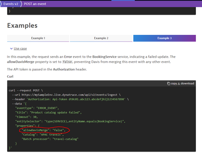

I am a bit confused about the reserved properties to be honest, on the events documentation I didn't find info on everything and the example that is mentioned on the page has the allowDavisMerge property as a string value, is the example wrong?
https://www.dynatrace.com/support/help/dynatrace-api/environment-api/events-v2/post-event#examples

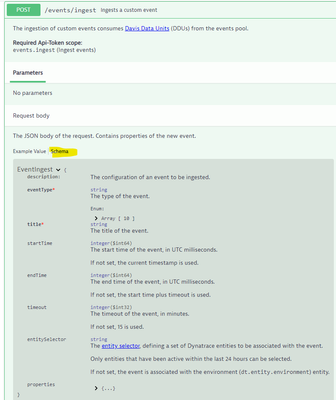

I usually look at the schema part in the Rest API UI
And trying to play around with the Rest API from the UI and check the outcomes, kind of trail and error.
