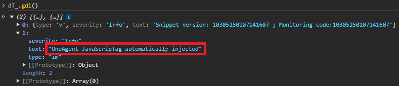

To ascertain the type and format of an injection, I utilize the following function in the Developer Tools console of the web page associated with the application: dT_.gdi() (Source). The output provides various details, for instance:
In my exploration of this function, I have identified a few key points:

I just retested everything and can not confirm your findings regarding dT_.gdi(). (I can however confirm that the documentation regarding the data-dtconfig attribute is wrong and will follow up on that internally).
These are my test results:

In my samples dT_.gdi() detected all formats correctly. The thing you mentioned is that dT_.gdi() is searching for "defer", but the only difference is "async", seems to be a misunderstanding though. Internally our config flag is called "async" to tell the JavaScript code to inject the deferred code (this goes back to the time we were still working on appmon).
But this is an internal detail and AFAIK not documented anywhere. The dT_.gdi() function correctly identifies it as deferred snippet though.
