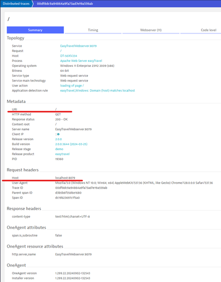

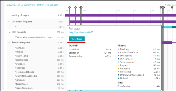

  • The third method is better because it will help you solve the problem faster (but here we're also assuming that correlation is working, so the User Actions are linked to the Distributed Traces), by checking your session in Dynatrace you're able to jump to the traces captured in Dynatrace. And from those traces you're able to see what the full URL looks like when it was captured:
  • Next check Settings -> Web and mobile monitoring -> Host determination. You could have used another header to use as a HOST for the trace.
  • Now you can build the full URL its the (Top header from the host determination + URI), for example here the full URL here would be: localhost:8079/

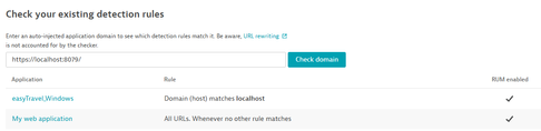

  • Next check the application detection rule and it states why this request was assigned to the application, in this case it states that the domain matches localhost.
You will either have to fix the detection rule or fix whatever is changing his URL (Dynatrace does not manipulate the URL we only capture it).
