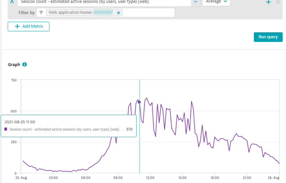

I am wondering why counts are higher in graphs when timescale is larger (day), then when zoomed in.
I realise when you zoomed in the detail moves from up to minute detail - although that detail doesn't show.
But the information looks distorted that if on day view you think 500+ users are active at 11 AM, but when zoomed in there appear 180 users to be active at 11 AM. You do not expect this behaviour, and when reporting to the user on amount of visitors has to be taken in account.
It appears users/sessions in the displayed time unit are summed, not averaged.

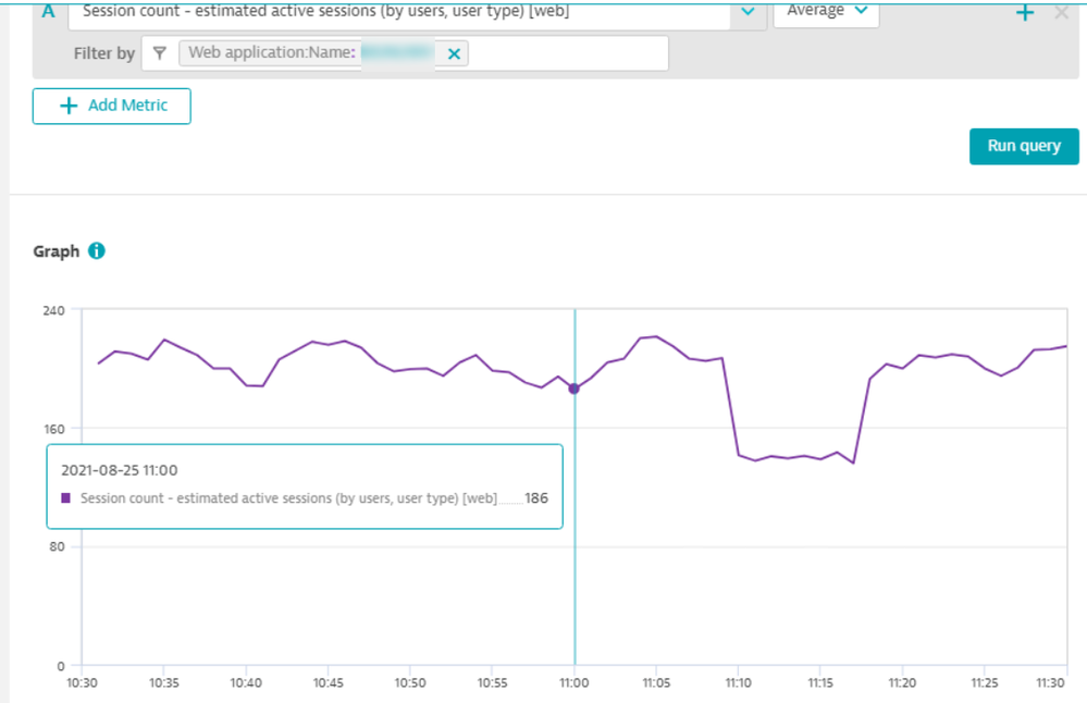

Day view, 11:00, sessions (avg) 570:  (5 minute)

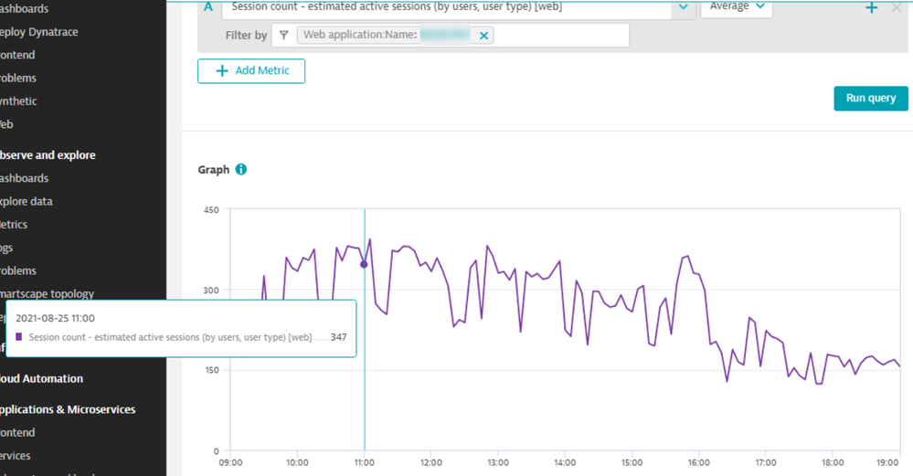

Work hours view, 11:00: 347 (5 minute)
Hour view, 11:00: 186  (minute)
