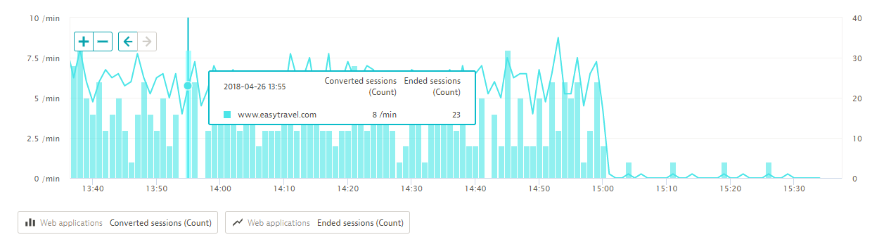

And how can I check that?
You could probably use custom charting (or the User sessions view) to compare the metrics for converted sessions to ended sessions and do some calculations off of that to make sure it is close to your conversion rate like so and then compare it to the conversion rate which is also available as a metric in custom charts. My quick test in our demo environment looks to be right (8/35 = 35%).

Thanks a lot James.
Would be better could to confirm it by Conversion Goal, but It's enough to me.
