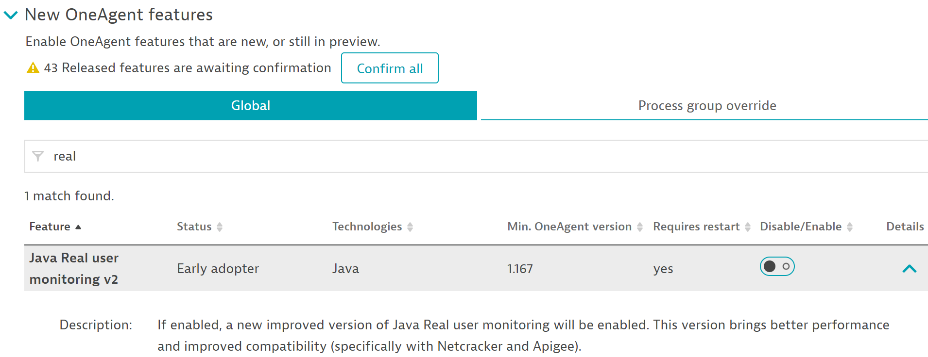

i want to enable RUM V2 in my environment, but there are few informations in documentation about it (maybe because it's an early adopter). In screen below there is a switch On/Off:
So, i have some questions:
1) There is a best practice to enable it? Or just switch On?
2) There is a detailed documentation about it?

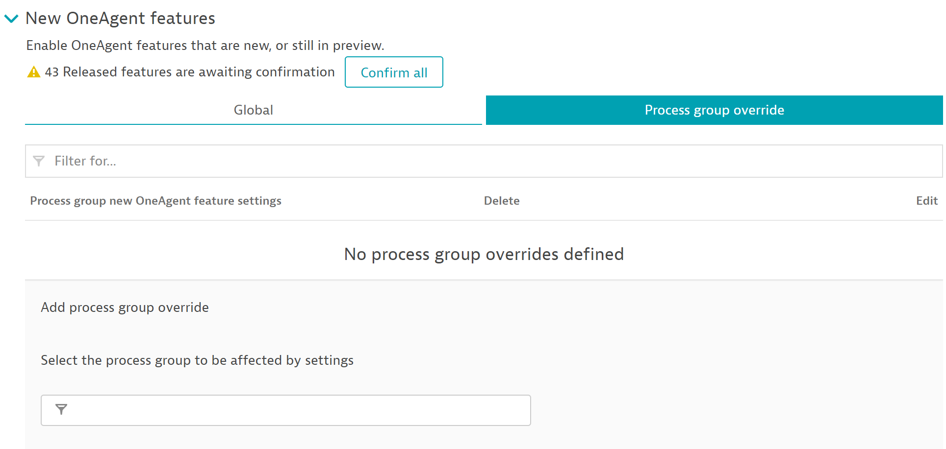

3) There is a Process Group Override section, so i can select a specific process group when i enable RUM V2 or i must enable it for whole environment?

  1. You can go ahead and enable it if you are using java web/app servers for RUM.
  2. Documentation is internal and nothing is publicly available. Most of the changes are architectural to solve certain quirks that the older version had and you won't really see any noticeable impact after enabling it
  3. Yes you can enable it at the process group level
  4. You would have to restart the process
