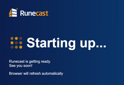

When the Runecast Web interface is stuck on the loading page after the appliance is rebooted, it is likely because of an interrupted update. This article explains how to diagnose and remediate this issue.

When this happens, the Runecast Web interface is stuck on the loading page:
