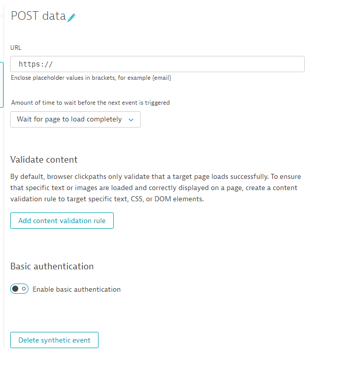

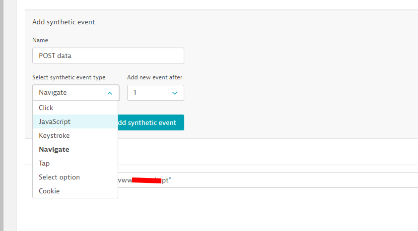

Not sure what "fetch" you are referring to?
Yes, the Navigate is the first. After that I have the following options:
Navigate seems the only option that could support a POST, but it is very limited in what we can do:
