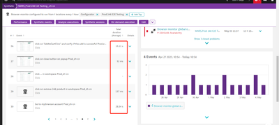

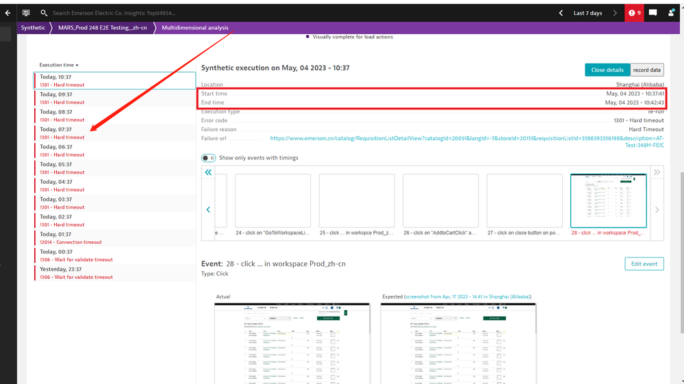

Hello, I encountered one issue for one couple of days. Our one synthetic monitor is often failed due to hard timeout error. But I checked each step of this monitor, The sum of all the step total duration it less than 5 minutes. But the monitor failed. I checked the failed step, there's no any useful information. So I have some questions:
1) Is the total duration time for all steps equal to the total execution time of this synthetic monitor?
2) We test the application and found the total duration is within 5 minutes. But the monitor failed. So, does anybody knows how I can get to know if the issue is due to Dynatrace cloud service issue or not?

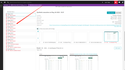

Thanks for your confirmation. I checked all the executed steps. On the 12th step, there are two 3rd party components were pending. But the 12th step executed successfully every time. And the monitor will be failed on 24th step nearly every time and without pending or timeout request. So, Could you check or restart your cloud service if there's no another solution for this issue?
The monitoring is failing with a hard timeout, the timings of every event count towards that, os if you can speed up the monitor then that should help here.
