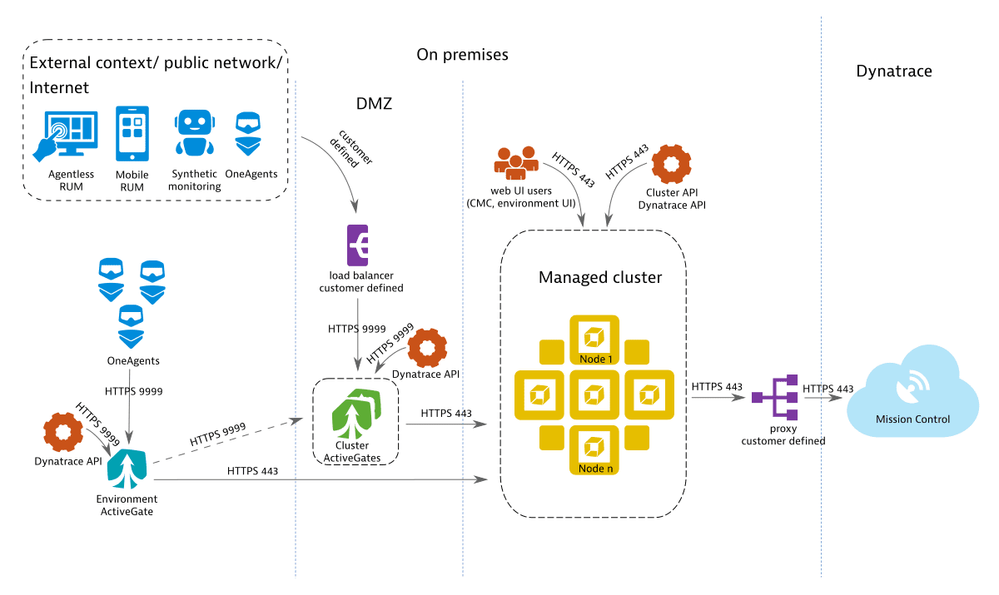

In a Managed environment, do we need to set up a Cluster ActiveGate in order to be able to see and select the public (Dynatrace hosted) locations when creating a Synthetic monitor?
Thanks
04 Nov 2022 02:24 PM
Yes.
The Cluster ActiveGate requires:
04 Nov 2022 03:43 PM - edited 04 Nov 2022 03:44 PM
Even more important. It's required as endpoint to receive the data from the public locations.
Agentless Real User Monitoring, mobile-app monitoring, and synthetic monitors all use the same endpoint to transmit monitoring data to Dynatrace.
You do not need to, but it's advisable to deploy behind a load balancer, especially when you deploying more than one CAG's. See the link ratislav shared.

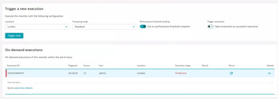

Hi guys,
I believe that execution command is sent to Mission Control that coordinate the run on public location and the public location is sending the execution outcomes thru the CAG to DTMC.
Question is if we get timeout on demand execution where can we see the error is it from DTMC --> MC / Public location --> CAG --> DTMC?
Is there a log we can get from somewhere?
25 Jun 2023 07:33 PM
@Yosi_Neuman you are right about the flow.
Afaik there is no log on the cluster ag, but if you have any sort of reverse proxy / load balancer, then you can check if the response arrived.
See my post about public endpoints, where you can find the URLs where synthetic monitored send data to managed cluster. Common reasons for not receiving synthetic data include WAF on the reverse proxy or incorrect certificate.
