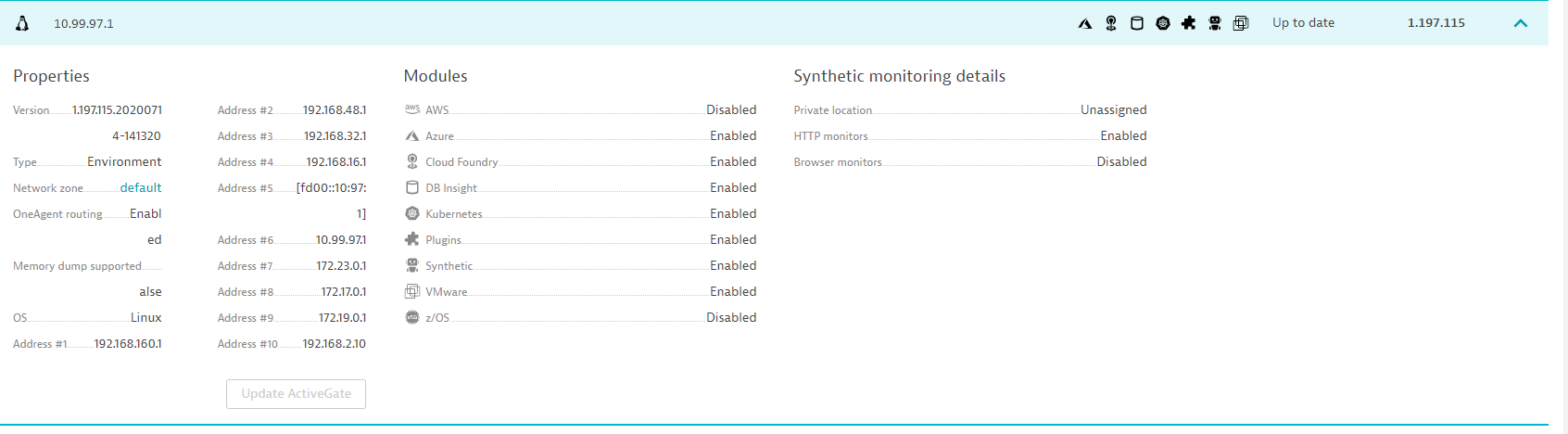

HTTP Monitors are no longer enabled by default for Active Gates that route oneagent traffic, as there are Synthetic Active Gates now.
If you just want to run a few HTTP Monitors you can still enable it though
In /var/lib/dynatrace/gateway/config/custom.properties add the following:
[synthetic]
synthetic_enabled = true
This will enable only HTTP Monitors (not Browser Monitors) for the activegate:
Worked flawlessly! Just would add that I had to do a restart of the Activegate.

Just a quick note that the tenant 1.211 upgrade broke the AG where I had this working... I had not updated the AG, just in case, but synthetics stopped working after AG was notified of the tenant upgrade.
I then tried to updade AG, but it gives me some error like:
18/02 22:31:45 Package Dynatrace-Synthetic-Linux-x86-1.209.36.20210208-102539.sh is being installed. Please wait...
18/02 22:31:45 ERROR: Root must not be used to run Synthetic services! Remove USER parameter from installation command or choose another user.
18/02 22:31:45 Installation failed.
18/02 22:31:45 ERROR: Installation process failed. Exit status (5)

So I figured this one out: I had an old version of Activegate installed. That version was still one that was running as root. I uninstalled it, and installed the new version. It then started running as a different user, and now I have the gateway&synthetic running 🙂
