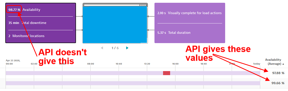

Synthetic API gives availability by location, but not the aggregated value. I think the following image explains the idea:

Hi Antonio, did you have a look at the metrics API? I think this should be possible with the merge transformation. See https://www.dynatrace.com/support/help/shortlink/api-metrics-v2-selector#merge-transformation for details.
Kind regards, Philipp
Yes, you are right!. Just changed my script and it's not splitting the value any more.

The curl is the one I referenced in my post on 19 May 2020. To do what I was asking for, you have to add the merge transformation, as referenced in the link that Philipp_Kastner referenced.
