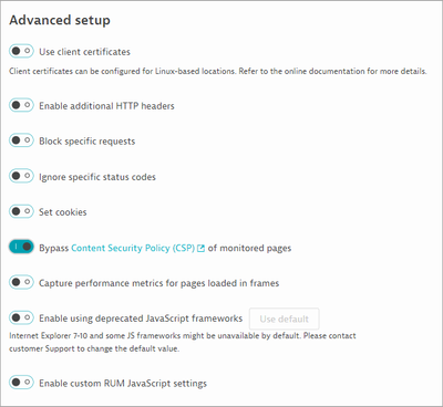

Preferred solution: Monitor settings
As a first and preferred method to bypass the CSP of any monitored pages in your single-URL browser monitor or browser clickpath, enable Bypass Content Security Policy (CSP) of monitored pages in monitor settings. You can do this in Additional options when creating a browser monitor or in Advanced setup in monitor settings in edit mode.
Bypass CSP in browser monitor settings
If you're unable to use this option for some reason, refer to the advanced methods for bypassing CSP below.
