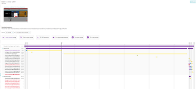

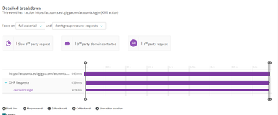

I am facing similar issue. Sometimes I noticed that on this steps I do not have full waterfall.
Over the past week, I observed that the waterfall data was fully captured only once, as shown below:

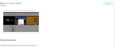

However, for other similar runs during the same period, the waterfall data was missing, as illustrated here:
I would appreciate any insights or recommendations on how to resolve this issue. Are there specific configurations or conditions that could be affecting the consistent capture of waterfall data?

Thank you for the detailed advice. I tried the steps you suggested, but I still have the same issue. I can't see the CSS element/image that I should be seeing. You can check the screenshot below for more details.
