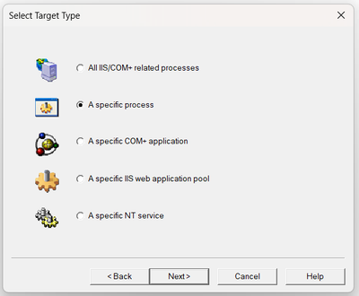

  3. In “Select Target Type” select “A specific process” and click on Next.
    Note: If the target is a web application hosted on IIS then, choose either “All IIS/COM+ related processes” or “A specific IIS web application pool”.

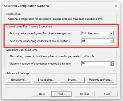

  5. In “Advanced Configuration (Optional)” under “Unconfigured First Chance Exceptions” set the following:
    Action type for unconfigured first chance exceptions: Full Userdump
    Action Limit for unconfigured first chance exceptions: 10

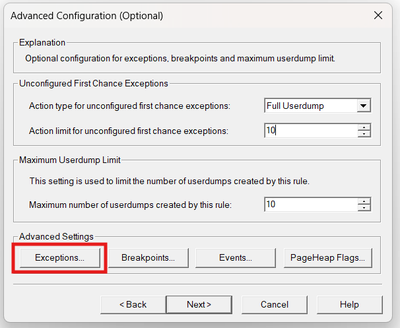

  1. In “Advanced Configuration (Optional)” click on the Exceptions… button :
