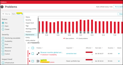

1. Check if the problem was created
Go to the Problems page and use the available filter to look for the problem.
For example, my problem is "Test123".
2. Verify the alert profile configuration
Ensure that the alert profile configured in Dynatrace to trigger notifications is linked to the problem.
For example, my alert profile is "JT".

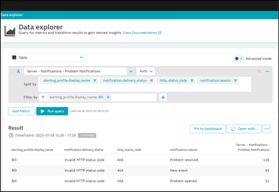

3. Use Data Explorer
Go to Data Explorer and select the metric "Server - Notifications - Problem Notifications (dsfm:server.notifications.problem_notifications)". Filter the concerned notification configuration to find out if there was any error while sending the notification.
Other valuable dimensions (notification.type, notification.display_name, notification.reason, http_status_code, alerting_profile.display_name, executed_retries, notification.delivery_status, http_status_class, notification.id, alerting_profile.id, will_retry, problem.status)

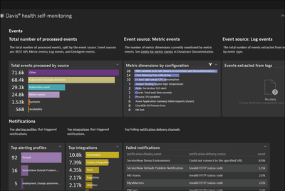

More details can be viewed from the preset Dashboard: Davis® health self-monitoring
