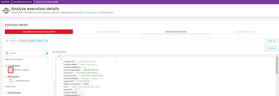

  1. Open the HTTP Monitor details page
  2. Click on 'Analyze execution details'
  3. Select the execution you are interested in, make sure you select the location if there is more than one in the list.
  4. Take a note of the engineId
  5. The engineId is shown in decimal format here but we use hex in the ActiveGates page, so you need to convert it. You can use the conversion on your calculator or an app online for this.
    In this case 1532483830 is 5B57D8F6 in hex.

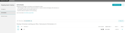

  6. Open the Deployment Status> ActiveGates page
  7. Filter by ID and enter the hex id. The ID has a 0x in front, so will be 0x5B57D8F6 for this one.
