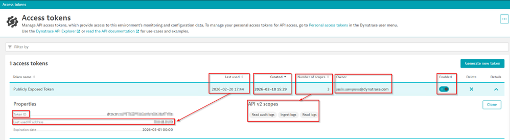

Step 1: Reviewing the Token in the UI
Navigate to the Access Tokens application in your tenant UI and identify the token that has been exposed. An example for Personal Access Tokens is also provided.
New Dynatrace UI:
https://{your-environment-id}.live.dynatrace.com/ui/apps/dynatrace.classic.tokens/ui/access-tokens
https://{your-environment-id}.live.dynatrace.com/ui/apps/dynatrace.classic.personal.access.tokens/ui/personal-access-tokens
Dynatrace Classic UI:
https://{your-environment-id}.live.dynatrace.com/ui/access-tokens
https://{your-environment-id}.live.dynatrace.com/ui/personal-access-tokens
Here you can check:
  • Creation date
  • Last used timestamp
  • Last used IP address
  • Assigned scopes
    • Token scopes can help estimate the impact of the event at a glance, for example the scope to ingest logs could impact integrity but not confidentiality, because a potential attacker would not have been able to extract data.
  • Token status (enabled/disabled)
If the token was publicly exposed, it is best to assume it may have been accessible to third parties.
Our recommendation:
Immediately disable or delete the token and verify whether the “Last used” timestamp aligns with expected activity.
