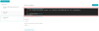

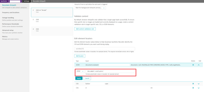

Browser Clickpath Monitors support DOM and CSS locators out of the box. This covers most scenarios, but for some applications, an XPath locator is needed. This article will explain how to select one.

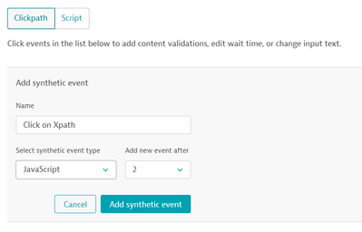

You can either use the XPath locator directly as a locator or use a JavaScript event for clicking.
document.evaluate('xpath', document, null, XPathResult.FIRST_ORDERED_NODE_TYPE, null).singleNodeValue
function getElementByXpath(path) {
    return document.evaluate(path, document, null, XPathResult.FIRST_ORDERED_NODE_TYPE, null).singleNodeValue;
a1 = getElementByXpath('xpath');
a1.click();
