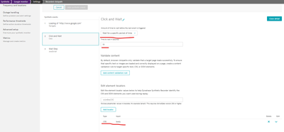

Option 2 - Add a Click event​
Since the default timeout is 60 seconds per event, you can add an event after the event that is experiencing timeouts to allow up to 60 seconds of further wait time.
  1. In the browser clickpath's settings, open the Recorded Clickpath.
  2. Select Add synthetic event.
  3. Set the synthetic event type to be Click.
  4. Set the new event to be added after the failing one.
  5. Set the wait time of the new event to 'Wait for Next event' or another suitable wait.
  6. Add a locator for the event.
    Select Type CSS and add body to the Input field.
  7. Set the wait time of the original, failing event to be for a specific amount of time, up to 60 seconds
This technique allows additional wait time. If more than 60 seconds is needed, another event can be added. By using a click on the body element, there is some validation that a page is loading. If there is no body element to click on, this step will fail, indicating that the page isn't even starting to load after the initial step.
