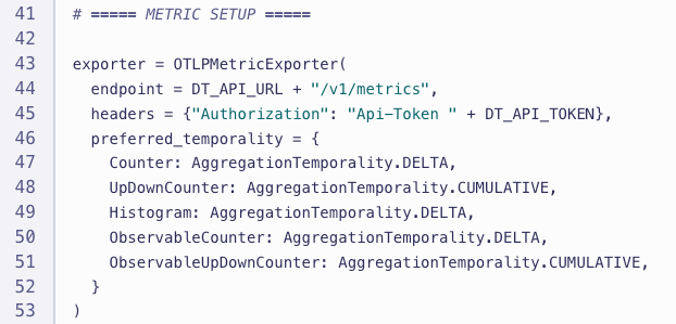

If your OTel SDK does not support the environment variable, then you can set it directly in code, where you set up the metrics SDK. An exampe of how to do that in Python can be seen in the screenshot below and also be found on the documentation page.
