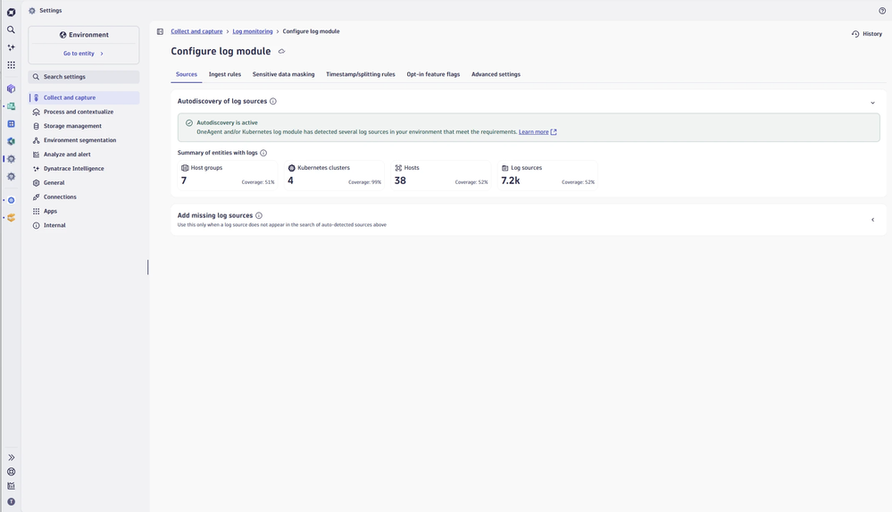

Step 2: Open the Sources tab
Open:
Settings app > Collect and capture > Log monitoring > Configure log module > Sources
Select the relevant host group, Kubernetes cluster, host, or workload. Search for the expected source path or name.

Step 5: If the source is detected, review coverage
If the source appears in the Sources tab but is not covered, no ingest rule applies to it. Records are not being collected.
  1. Review the source attributes shown in the Sources view.
  2. Identify the intended ingest rule.
  3. Compare its matcher with the current source attributes.
Critical distinction: The log source matcher matches the log source name, not the file path.
  • Example: a matcher /path/a.2026.log does not match a source named /path/a.#.log, even if the file /path/a.2026.log exists in the filesystem.
  1. Review the rule's scope  confirm it applies at the correct level (environment, host group, host).
  2. Correct or create the rule according to the intended collection policy.
