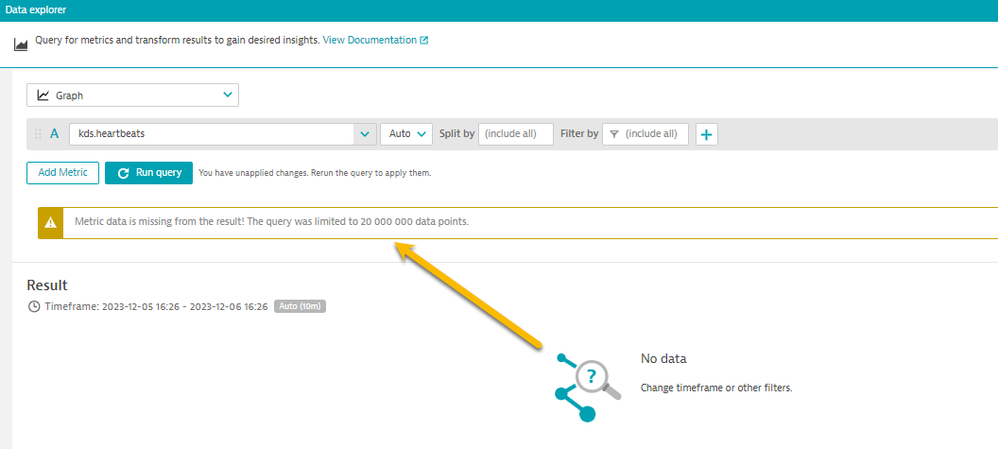

Query limits
In Dyntrace classic, you might see not all/no results if you face a metric query limit. In the example below there is no data shown because the metric query limit of 20 million datapoints is reached. On the platform, this limit is increased to 500 million datapoints.
