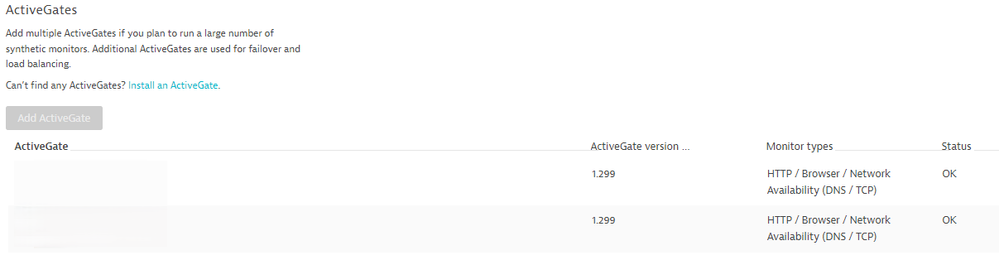

After deploying Synthetic-enabled ActiveGates and assigning them to a new private Synthetic location, the location appears as “Not supported” when attempting to create an ICMP (Network Availability) monitor.
In the Dynatrace UI:

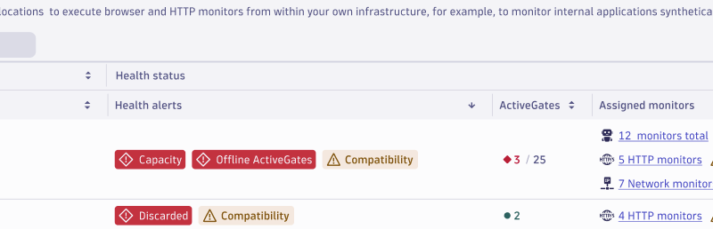

  • Synthetic app> Private locations. The private location shows a Compatibility health alert.
  • Network Availability (ICMP) is missing from the available monitor types in Classic Settings> Web and Mobile monitoring> Private Synthetic locations> Edit location.

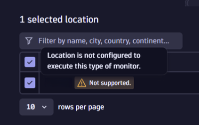

  • The private location marked as Not supported, with an message indicating that the Location is not configured to execute this type of monitor.
  • ActiveGate diagnostic logs, vuc-status.log, show that ICMP is marked as unavailable, even though other Synthetic capabilities (Browser, HTTP, TCP, DNS) are operational.
