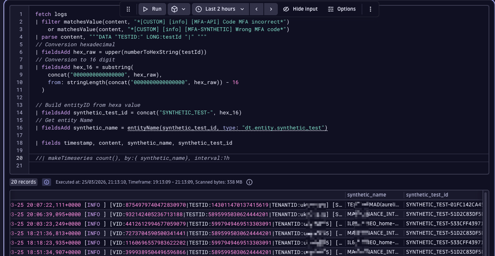

Hi  @HannahM ,
Sorry for coming back to this quite late, but I was busy with other topics.
Thank you very much, I was able to correlate custom events in the synthetic ActiveGate logs with the name of the synthetic monitor :
This will allow me to set up alerts based on the number of occurrences of custom events in my synthetic tests, generated through api.info().
Thank you very much for your support.
