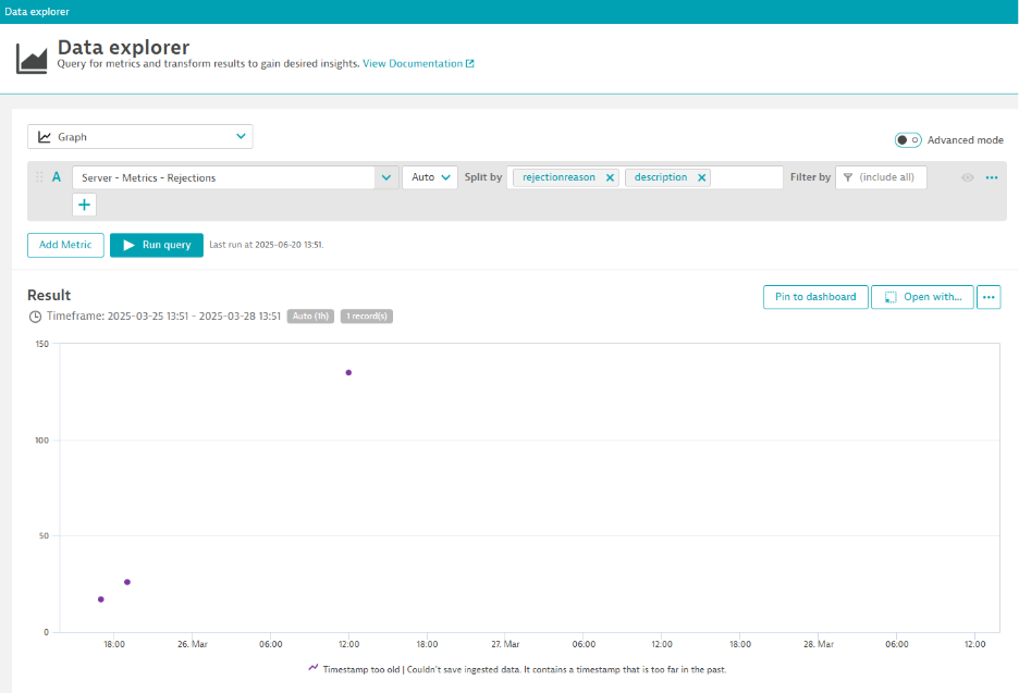

  2. Verify the result of metric dsfm:server.metrics.rejections. Common cause of issue are exhausted DDUs. maciejtokarz_1-1753778388336.png

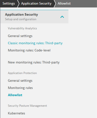

  3. Verify Application Security rules.

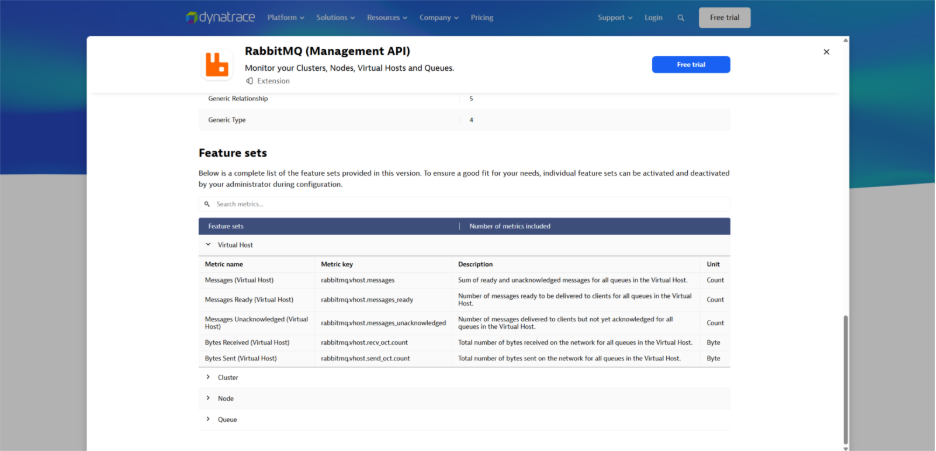

  3. Download the extension package from the Dynatrace Hub.maciejtokarz_1-1753782344024.png
    Notice: The information about metrics collected by extension is often described in the "Product information" section.

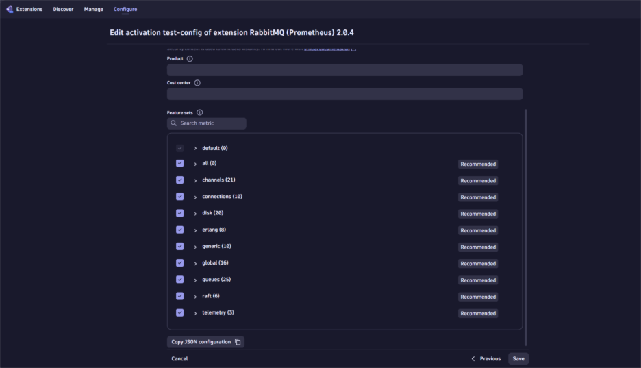

4.Feature set is disabled
Symptoms
 The extension and response of the source contain the metric, but the data is not visible.
Troubleshooting
 Check if the feature set that contains the metric is enabled.

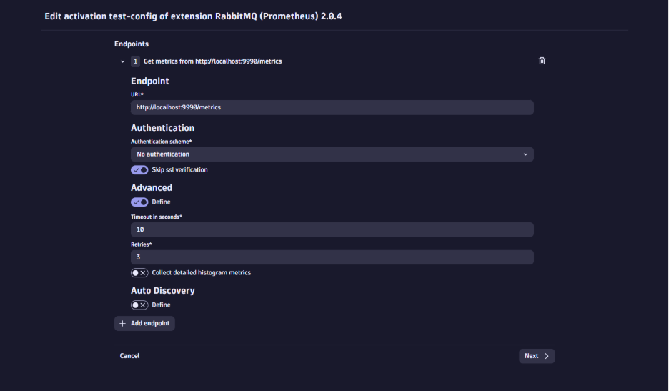

  2.  Increase timeout/retries in the extension monitoring configuration (section advanced). maciejtokarz_1-1753783589085.png
    Notice: Retries * timeout should not be greater than min interval in the extension.

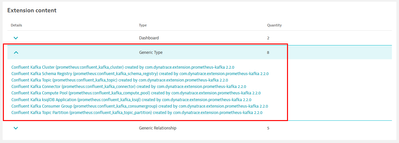

An extension can  create the generic type entry in Dynatrace environment. There is default limit for such generic entities which is 100k. When one of the generic types of your Prometheus extension reach the limit, the sudden lack of fresh data might occur.
In Dynatrace HUB you can check what Generic Type entities are created by your extension :
Troubleshooting:
To troubleshoot this issue you can follow the steps :
  1. Go to Dynatrace HUB and click on your Extension
  2. Go to Extension Content -> Generic Type
  3. Open each Generic Type and look for warning message like this
  4. Open a new ticket in Dynatrace Support and share details and the name of the problematic Generic Type.
