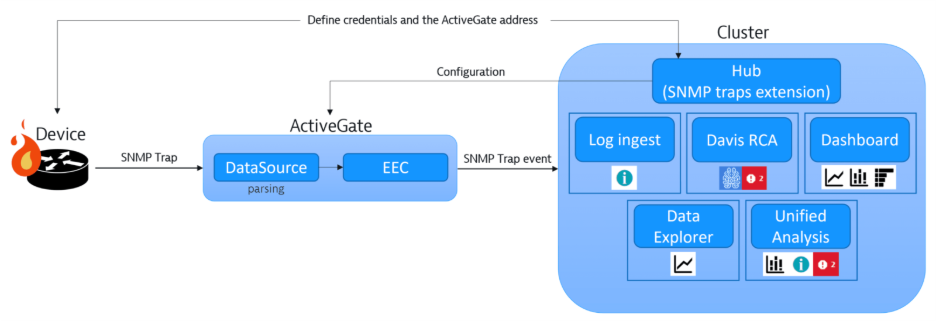

SNMP Traps (com.dynatrace.extension.snmp-traps-generic) is a special extension that generates Log Events based on the captured traps in the network. It also produces single metric com.dynatrace.extension.snmp-traps-generic.traps.count that is number of captured traps in the interval.
SNMP Traps extensions use datasource that binds to and listens on the configured UDP port. Incoming packets are filtered by the configured IP address and mask. Finally, the packets are verified against provided credentials (v1, v2c, or v3). If there were no errors along the way, the Log Events should be visible in the Logs screen.

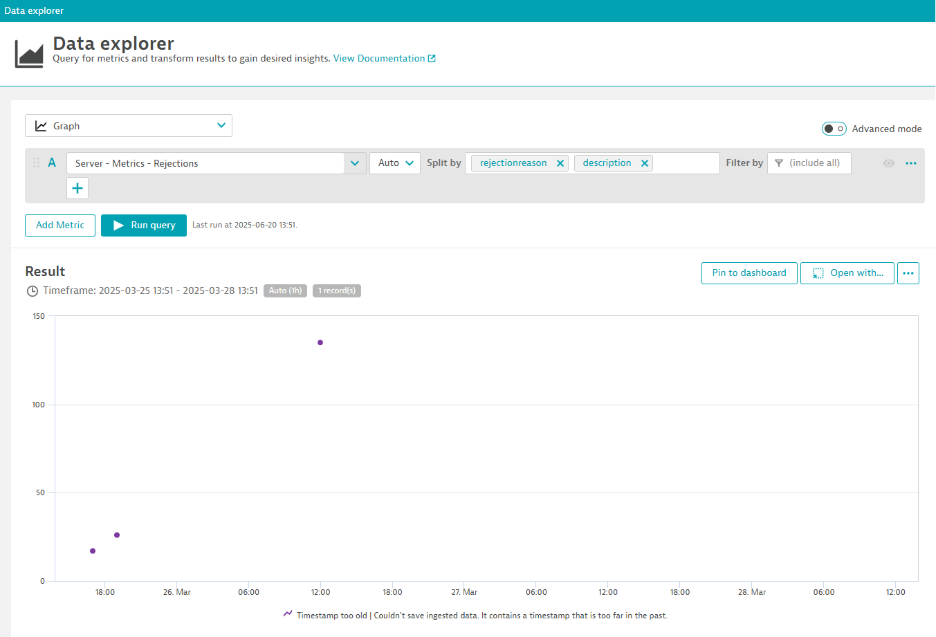

  • Verify the result of metric dsfm:server.metrics.rejections. Common cause of issue are exhausted DDUs.

Rejected Metrics
Troubleshooting

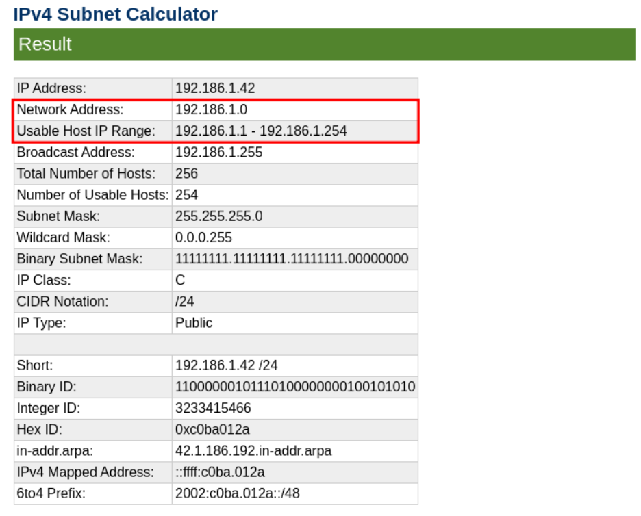

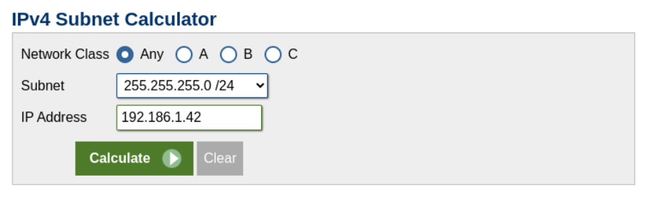

Each monitoring configuration for an SNMP Traps extension has a field that configures the IP address space in CIDR Notation that expected SNMP Traps will be received from, sometimes it may be a /32 listing for a single host up to /8 for an entire class A private network full of IP addresses.
If you are unfamiliar with the process of calculating subnets and determining the IP addresses that would be contained in the address space, a subnetting calculator tool can be utilized to determine the valid IP range. For example, this subnet calculator that takes the input of the subnet mask and an IP address and provides the network address and usable IP range among additional details.
Input
Output
Notice: The IP address/Mask used in the extension monitoring configuration must match the source IP address of the packet that the datasource 'sees' - therefore, if a proxy is used, the extension monitoring configuration must be configured with the IP address/Mask that includes the proxying service IP address.

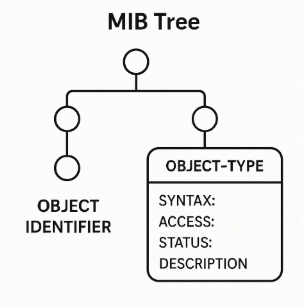

MIBs issues
Troubleshooting
The SNMP traps data source uses a default set of MIB files. You can also extend the default set with your own files. There are often issues with loading MIBs and translating OIDs based on the MIB files https://docs.dynatrace.com/docs/ingest-from/extensions20/data-sources/snmp-extensions/snmptraps-exte....
  • Verify if the traps are translated after changing the SNMP version. For example, from SNMP v1 to SNMP v2c. It can mean that the MIB module cannot support all SNMP versions, and an updated MIB file is required.
  • Verify NOTIFICATION-TYPE in the MIB file. Some vendor's MIB modules, and even some RFCs, defined a NOTIFICATION-TYPE with a parent of zero but without an object name for that zero, which results in incorrect MIB resolution by our SNMP traps datasource. More information can be found at the link https://www.ibm.com/docs/en/netcoolomnibus/8.1.0?topic=snmp-mib-object-types#omn_ref_mib_mibobjects_....For example:
    • At the start of the mib, this is defined.
      netapp0 OBJECT IDENTIFIER ::= { netapp 0 }
    • Then there is some kind of overlap.
      ::= { netapp 0 1131 }
          Potential solution:
Try to manually updating mib file to change ::= { netapp 0 x} to ::= { netapp0 x} or remove all '0' in all objects (expect for netapp0).
  • Verify if in the MIB file in the fragment DEFINITIONS ::= BEGIN, there are excessive whitespaces in between ::= and BEGIN and there should be only a single space.
  • Check MIB files defines the names from the ROOT, otherwise OIDs are not resolved correctly.
  • SmiType is nil - it is common warning log SmiType is nil. Module name <module_name>, if the warning in the log file doesn't lead to a missing OID name resolution, it can be discarded. It occurs, because SmiType is verified to be non-nil before parsing. Potential causes:
    • SYNTAX clause of a Textual Convention can refer to a previously defined Textual Convention (RFC 2579).
      DisplayString ::= TEXTUAL-CONVENTION
        DISPLAY-HINT    "255a"
        STATUS          current
        DESCRIPTION     ""
        SYNTAX          OCTET STRING (SIZE (0..255))
      ObjName ::= TEXTUAL-CONVENTION
        STATUS          current
        DESCRIPTION     ""
        SYNTAX          DisplayString (SIZE (0..32))
    • MIB object does not define a type (syntax).
