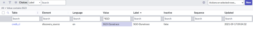

To allow Dynatrace to report discovered configuration items (CIs) in your CMDB, verify that the discovery data source SGO-Dynatrace exists.
=SGO-DYNATRACE and run a search.Configuration Item [cmdb_ci]discovery_sourceSGO-DYNATRACESGO-DYNATRACEIf the hosts, process groups, services, and applications still don't show up in the CMDB, check the ServiceNow System logs for error messages within the Identification and Reconciliation engine. It might be that a non-standard CMDB-type attribute has been defined as a mandatory field.
For more information, refer to ServiceNow documentation on the Service Graph Connector for Observability - Dynatrace. Also check Send Dynatrace notifications to ServiceNow in Dynatrace Documentation.
