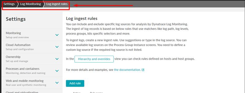

Alternatively, to reduce the processing of incoming log events and contribute to less saturation of the log queue within Elasticsearch as event ingestion is attempted.  You can reconfigure the base log filter to only ingest relevant logs in the log ingest rules instead of all logs.
Go to Settings --> Log Monitoring --> Log ingest rules
Note: You can check DDU consumption of log monitoring in your environment, which provides an approximate measure of the log sources sending the most logs, to help you control log ingesting rules and reduce them if possible.
Consumption -->  Davis data units --> Log
