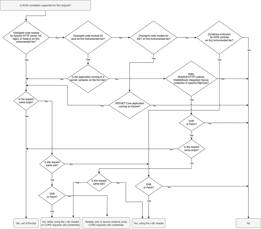

Verify that RUM correlation is supported in your scenario
Out-of-the-box RUM correlation is not supported in all scenarios—and in some cases, it’s not supported at all. The key factors to consider are:
These factors can vary across different requests within the same application. Therefore, if you encounter RUM correlation issues, it’s important to examine individual requests. Use the decision tree below to determine what applies to the specific web request you're analyzing. For definitions of "same-origin" and "same-site", refer to Understanding "same-site" and "same-origin".
In scenarios where the decision tree calls for the use of the x-dtc header or for CORS requests with credentials, additional configuration is required. See Link cross-origin XHR user actions and their distributed traces for setup instructions.

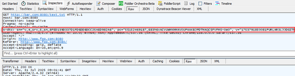

x-dtc header
To allow the RUM JavaScript to add the x-dtc header to requests, you need to define a regular expression that matches the target URL in the application configuration. For details, see Link cross-origin XHR user actions and their distributed traces.

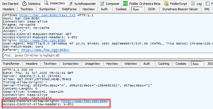

Adding the header triggers a browser preflight request—an OPTIONS request—which must be properly handled by your endpoints. If not, a CORS error will appear in the browser console.
Specifically, the preflight response must include the Access-Control-Allow-Headers: x-dtc header to permit the use of the x-dtc header. It must also include an Access-Control-Allow-Origin header that allows the requesting origin. Additionally, depending on the HTTP method used, the response may need to include an Access-Control-Allow-Methods header.
If the preflight request succeeds, the browser includes the x-dtc header in the actual request:
Note that only the actual request can be correlated—not the preflight request.

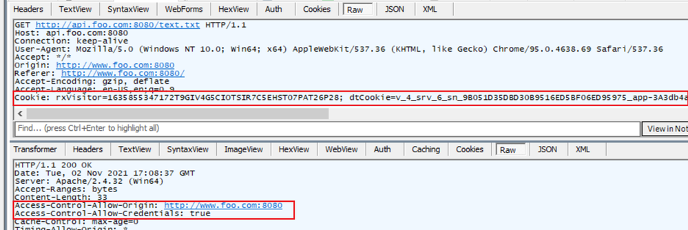

A CORS request with credentials is triggered when the monitored application:
  • Uses the withCredentials property with XMLHttpRequest
  • Sets the credentials mode to include with the Fetch API
  • Adds the crossorigin="use-credentials" attribute to HTML elements
The server must respond with an Access-Control-Allow-Credentials: true header and a specific Access-Control-Allow-Origin header (that is, not a wildcard). Failure to include these headers will result in a CORS error in the browser console.
You can confirm this setup by checking whether the browser sends RUM cookies, such as the dtCookie, on the request.
RUM cookies are only sent if they are applicable. Typically, you don’t need to explicitly configure the cookie domain, as both the RUM JavaScript and OneAgent automatically select the broadest possible domain. However, if cookies are missing from the request, verify that the cookie domain configuration does not restrict them to a subdomain that excludes the request in question.

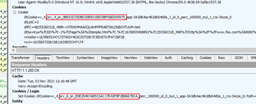

One key cookie used for RUM correlation is the dtCookie, which OneAgent can create and update. If the dtCookie is stripped from the Cookie request header before reaching the OneAgent, the OneAgent will generate a new one and return it in the Set-Cookie response header.
This newly generated dtCookie will have a different session ID and often a different server ID than the original as shown in the screenshot below. These mismatched identifiers prevent successful RUM correlation.

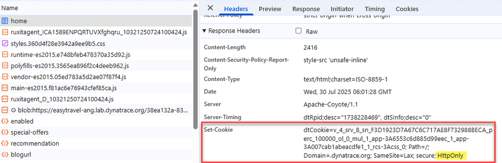

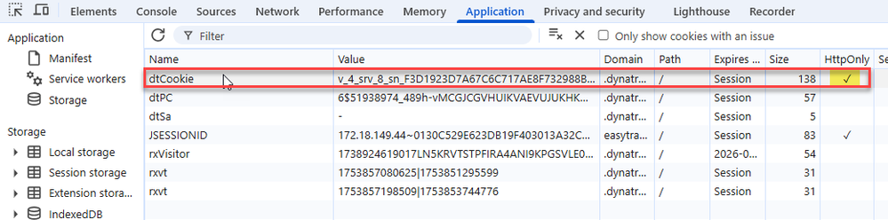

Infrastructure adding the HttpOnly attribute to the dtCookie
The HttpOnly attribute is not supported for RUM cookies, as it prevents the RUM JavaScript from accessing them. If your infrastructure adds it to RUM cookies, this will lead to RUM correlation issues—among other problems. To resolve this, the attribute must be removed.
How to Check for HttpOnly
To determine whether your infrastructure is adding the HttpOnly attribute, open the Application tab in Chrome DevTools and check whether the dtCookie is marked as HttpOnly.
In the Network tab, inspect the document request and examine the Set-Cookie response header that sets the dtCookie. If the header includes the HttpOnly attribute, it confirms the issue.

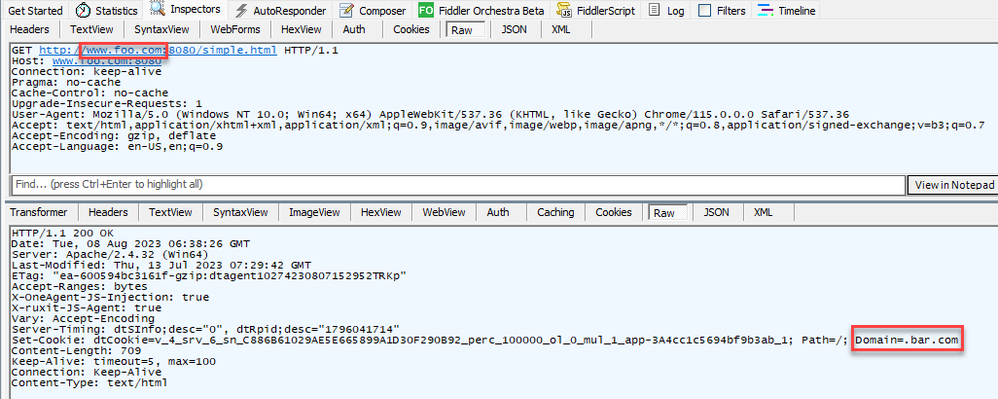

Cookie domain issues
If the domain assigned to the dtCookie does not match the domain of the request—as shown in the screenshot below—RUM correlation will fail.
This mismatch can occur for two reasons:
  • Automatic domain detection fails because host name determination was not configured correctly.
  • The cookie domain was manually configured to a domain that doesn't cover the request domain.
For more details, refer to Configure the RUM cookie domain for web applications.
