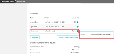

Chromium
Why does Chromium show as failed or skipped when it's up to date?
When viewing Deployment Status → ActiveGates → ActiveGate, you may see the Chromium Last Update status listed as Failed or Skipped despite Chromium being on the expected version
Answer
The Synthetic installer determines the Chromium Last Update status.
Here’s why the status may not show “OK”:
Previous Chromium autoupdate failed
  • If a Chromium autoupdate attempt fails, the Last Update status is set to Failed.
  • If Chromium is later manually updated, the version will be correct, but the status will remain Failed.
Chromium autoupdate is disabled
  • If the autoupdate option is turned off, Chromium updates are skipped by the installer.
  • The Last Update status remains Skipped.
How to reset the status
The Chromium Last Update status will return to OK only after a successful Chromium update performed by the Synthetic installer.

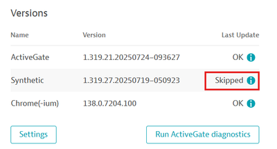

Synthetic module
Why does Synthetic show as failed, skipped, or rollback when it's up to date?
When viewing Deployment Status → ActiveGates → ActiveGate, the Synthetic module’s Last Update status may show Failed, Skipped, or Rollback, even though the module is up to date.
Answer
The Autoupdater sets the Last Update status for the Synthetic module.
Here’s what causes the unexpected status:
A previous update attempt failed
If the Synthetic module update failed earlier and you later:
  • uninstalled it
  • reinstalled it
    …the Last Update status does not automatically change.
The Synthetic Last Update field is refreshed only when the ActiveGate itself is next updated successfully.
