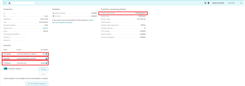

ActiveGate and Synthetic Module mismatch
Check if the Synthetic and ActiveGate major versions match. In the image above, they don't.
If the major versions differ, check this article to see why the Synthetic module failed to update.
