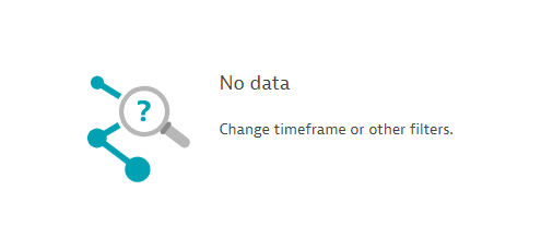

Whether you use Data explorer or Dashboards classic or even pull metrics via our API. You might have encountered a situation where as soon as you apply a Management zone filter your metric data disappears and "No data" message appears like here:
If you switch back to "All" Management zone filter the data is visible again.

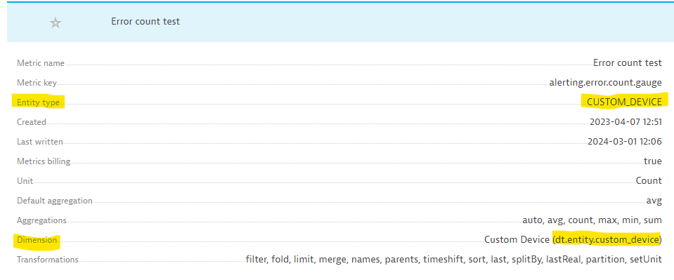

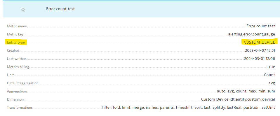

  1. Check if your metric has Entity type:

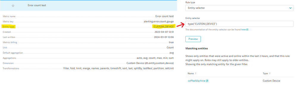

  2. Check if your metric has Entity type that matches your Management zone rule:
  3. Check if your metric has a topology dimension(if Entity type is defined but there is no data assigned to given entity then filter based on this entity will still not work):
If your metric does not have Entity type it would not be possible to match the data based on entity selector Management zone rules. For this scenario the suggestion is to either define the Entity type in metric metadata( https://docs.dynatrace.com/docs/shortlink/metrics-mz#metric-entity-type) or create dimensional rules for the Management zone.

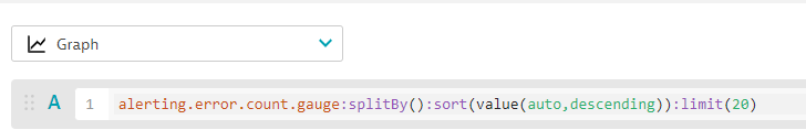

  • If using Data explorer in Advanced mode provide your metric selector query:
